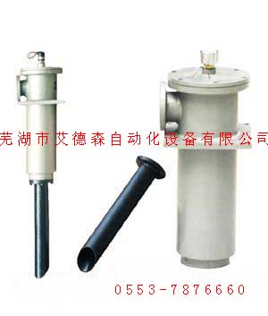

NJUϵÁÐÏäÍâÄÚ»ýʽÎüÓ͹ýÂËÆ÷
![](/Editor/UploadFiles/products02/200812591637928.jpg)
²úÆ·Ãû³Æ£º |
NJUϵÁÐÏäÍâÄÚ»ýʽÎüÓ͹ýÂËÆ÷ |
²úÆ·¼ò½é£º |
NJUϵÁÐÏäÍâÄÚ»ýʽÎüÓ͹ýÂËÆ÷£¬¾ßÓÐÁ¬½Ó·½±ã¡¢ÇåÏ´»ò¸ü»»ÂËоÈÝÒ×£¬Ò×ʵÏÖÓÍÏä·â±Õ»¯£¬²¢ÉèÓÐ×éºÏ·¨À¼¡¢ÅÔͨ·§¡¢ÎÛȾ»ýÎïÖÑ¡¢¶ÂÈû·¢Ñ¶Æ÷µÈ×°Öᣱ¾²úÆ·¾Ðí¶à¿ÆÑе¥Î»¼¼ÊõÉó²é£¬¾°Ù¼ÒÖ÷»ú³§ÅúÁ¿ÅäÌ×ʹÓúóÖ¤Ã÷£¬Ð§¹ûºÜºÃ¡£ |

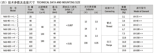

ÐͺŠ|
¹«³ÆÁ÷Á¿£¨1/min£© |
¹ýÂ˾«¶È£¨um£© |
ͨ¾¶£¨mm£© |
ÔʼѹÁ¦Ëðʧ£¨MPa£© |
·¢Ñ¶Æ÷×°Öà |
Á¬½Ó·½Ê½ |
ÖØÁ¿(kg) |
ÂËоÐͺŠ|
£¨V£© |
£¨A£© |
NJU-25¡Á*L-¡õ |
25 |
80
100
180 |
15 |
£¼0.007 |
12
24
36
220 |
2.5
2
1.5
0.25 |
¹Üʽ |
3.1 |
UX-25¡Á* |
NJU-40¡Á*L-¡õ |
40 |
20 |
3.8 |
UX-40¡Á* |
NJU-63¡Á*L-¡õ |
63 |
25 |
6.0 |
UX-63¡Á* |
NJU-100¡Á*L-¡õ |
100 |
32 |
6.7 |
UX-100¡Á* |
NJU-160¡Á*L-¡õ |
160 |
40 |
7.3 |
UX-160¡Á* |
NJU-250¡Á*F-¡õ |
250 |
50 |
£¼0.01 |
·¨À¼Ê½ |
12.8 |
UX-250¡Á* |
NJU-400¡Á*F-¡õ |
400 |
60 |
16.0 |
UX-400¡Á* |
NJU-630¡Á*F-¡õ |
630 |
80 |
18.0 |
UX-630¡Á* |
NJU-800¡Á*F-¡õ |
800 |
90 |
19.0 |
UX-800¡Á* |
×¢£º*Ϊ¹ýÂ˾«¶È£¬ÈôʹÓýéÖÊΪˮһÒÒ¶þ´¼£¬´øZS-I·¢Ñ¶Æ÷£¬Ôò¹ýÂËÆ÷ÐͺÅΪNJU¡¤BH-160¡Á*L-C£¬ÂËоÐͺÅΪXU¡¤BH-160¡Á*

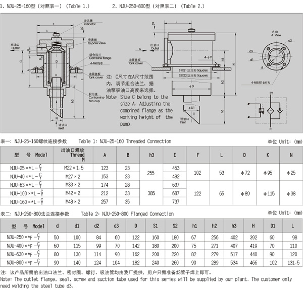

±íÒ»£ºNJU-25¡«160ÂÝÎÆÁ¬½Ó²ÎÊý
ÐͺŠ|
³öÓÍ¿ÚÂÝÎÆ |
³ß´ç£¨mm£© |
A |
B |
h3 |
E |
F |
L |
D |
K |
N |
NJU-25¡Á*L-¡õ |
M22¡Á1.5 |
123 |
23 |
255 |
453 |
102 |
53 |
¦Õ72 |
¦Õ95 |
¦Õ25 |
NJU-40¡Á*L-¡õ |
M27¡Á2 |
153 |
23 |
482 |
NJU-63¡Á*L-¡õ |
M33¡Á2 |
174 |
28 |
385 |
637 |
122 |
65 |
¦Õ89 |
¦Õ115 |
¦Õ38 |
NJU-100¡Á*L-¡õ |
M42¡Á2 |
212 |
33 |
687 |
NJU-160¡Á*L-¡õ |
M48¡Á2 |
257 |
35 |
737 | |
±í¶þ£ºNJU-250¡«800·¨À¼Á¬½Ó²ÎÊý
ÐͺŠ|
d |
d1 |
d2 |
d3 |
D |
S1 |
S2 |
h1 |
h2 |
h3 |
H |
D1 |
L |
NJU-250¡Á*F-¡õ |
50 |
100 |
84 |
60 |
122 |
160 |
180 |
67 |
256 |
402 |
392 |
60 |
98 |
NJU-400¡Á*F-¡õ |
60 |
115 |
99 |
70 |
142 |
180 |
200 |
75 |
271 |
407 |
419 |
70 |
110 |
NJU-630¡Á*F-¡õ |
80 |
130 |
114 |
90 |
162 |
200 |
220 |
82 |
279 |
517 |
440 |
90 |
120 |
NJU-800¡Á*F-¡õ |
90 |
140 |
124 |
104 |
182 |
240 |
260 |
90 |
289 |
534 |
466 |
102 |
131.5 |
×¢£º¸Ã²úÆ·ËùÐèµÄ³öÓÍ¿Ú·¨À¼¡¢ÃÜ·âȦ¡¢Âݶ¤¡¢ÎüÓ͹ܾùÓÐÎÒ³§Ìṩ£¬Óû§Ö»Ðè×¼±¸d3¹Ü×Óº¸Éϼ´¿É¡£ |
