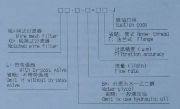

(¶þ)ÐͺÅ˵Ã÷:
![](/Editor/UploadFiles/products02/200812592854740.jpg)
