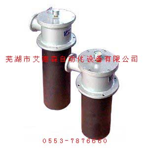

YLHϵÁÐÏäÉÏ»ØÓ͹ýÂËÆ÷ |
²úÆ·¼ò½é£º |
±¾¹ýÂËÆ÷ÊÊÓÃÓÚҺѹϵͳ»ØÓ;«¹ýÂË£¬ ÓÃÒÔÂ˳ýҺѹϵͳÖÐÓÉÓÚÔª¼þÄ¥Ëð²úÉúµÄ½ðÊô¿ÅÁ£ºÍÃÜ·âµÄÏð½ºÔÓÖʵÈÎÛȾÎʹÁ÷»ØÓÍÏäµÄÓÍÒº±£³ÖÇå½à¡£ ¹ýÂËÆ÷ÅäÓз¢Ñ¶Æ÷£¬ÅÔͨ·§ºÍ¼¯ÎÛÖÑ¡£ Ö÷ÒªÐÔÄÜÌصãÓУº 1£®¹ýÂËÆ÷Ö±½Ó°²×°ÔÚÓÍÏä¸Ç°åÉÏ£¬Í²ÌåÉìÈëÓÍÏäµÄÓÍÒºÖС£½øÓÍ¿ÚÉèÓÐÂÝÎƺͷ¨À¼Á¬½Ó·½Ê½£¬Óë»ØÓ͹Ü·Á¬½Ó£¬¹Ü·¼òµ¥£¬°²×°·½±ã¡£ 2£®µ±ÂËо¶ÂÈûʱ£¬Ö»Ðè´ò¿ªÉϸǣ¬ ¼´¿ÉÈ¡³öÂËо£¬ µ±¸ü»»ÂËоºó×°ÉÏÉϸǣ¬±ã¿ÉͶÈëÔËÐУ¬Ê®·Ö·½±ã¡£ 3£®ÔÚ¹ýÂËÆ÷½øÓÍ¿ÚÉèÓÐÂËо¶ÂÈû·¢Ñ¶Æ÷£¬¾ßÓÐÖ±¹ÛºÍ·¢Ñ¶Á½ÖÖ¹¦ÄÜ¡£Í¨¹ý¹Û²ì·¢Ñ¶Æ÷ָʾ±í£¬¿ÉÒÔËæʱÁ˽âÂËо¶ÂÈûÇé¿ö¡£µ±ÂËо¶ÂÈû£¬½øÓÍ¿ÚѹÁ¦´ïµ½¼¼Êõ²ÎÊý±íÖй涨ֵʱ£¬·¢Ñ¶Æ÷±ã»á·¢³öѶºÅ. |

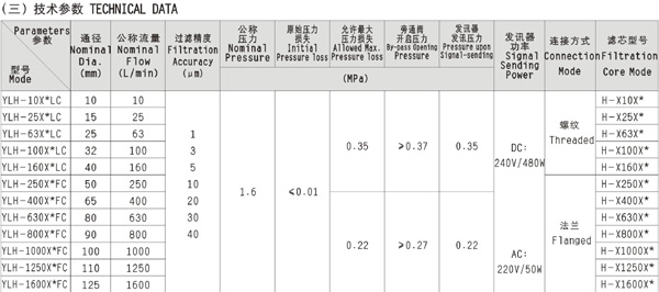

ÐͺŠ|
ͨ¾¶(mm) |
¹«³ÆÁ÷Á¿(L/min) |
¹ýÂ˾«¶È(¦Ìm) |
¹«³ÆѹÁ¦ |
ÔʼѹÁ¦Ëðʧ |
ÔÊÐí×î´óѹÁ¦Ëðʧ |
ÅÔͨ·§¿ªÆôѹÁ¦ |
·¢Ñ¶Æ÷·¢Ñ¶Ñ¹Á¦ |
·¢Ñ¶Æ÷¹¦ÂÊ |
Á¬½Ó·½Ê½ |
ÂËоÐͺŠ|
£¨MPa£© |
YLH-10¡Á*LC |
10 |
10 |
1
3
5
10
20
30
40 |
1.6 |
¡Ü0.01 |
0.35 |
¡Ý0.37 |
0.35 |
DC:240V/480W
AC:220V/50W |
ÂÝÎÆ |
H-X10X* |
YLH-25¡Á*LC |
15 |
25 |
H-X25X* |
YLH-63¡Á*LC |
25 |
63 |
H-X63X* |
YLH-100¡Á*LC |
32 |
100 |
H-X100X* |
YLH-160¡Á*LC |
40 |
160 |
H-X160X* |
YLH-250¡Á*FC |
50 |
250 |
·¨À¼
H-X250X* |
YLH-400¡Á*FC |
65 |
400 |
0.22 |
¡Ý0.27 |
0.22 |
H-X400X* |
YLH-630¡Á*FC |
80 |
630 |
H-X630X* |
YLH-800¡Á*FC |
90 |
800 |
H-X800X* |
YLH-1000¡Á*FC |
100 |
1000 |
H-X1000X* |
YLH-1250¡Á*FC |
110 |
1250 |
H-X1250X* |
YLH-1600¡Á*FC |
125 |
1600 |

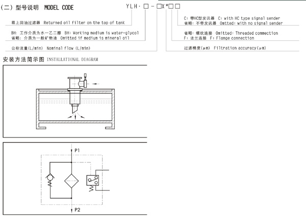

H-X1600X* | ×¢£º*Ϊ¹ýÂ˾«¶È£¬ÈôÑ¡Óù¤×÷½éÖÊΪˮһÒÒ¶þ´¼£¬Á÷Á¿Îª100L/min£¬¹ýÂ˾«¶ÈΪ3¦Ìm£¬´ø·¢Ñ¶Æ÷µÄ¹ýÂËÆ÷£¬ÆäÐͺÅÔò±êΪ£ºYLH¡¤BH-100X3C |
