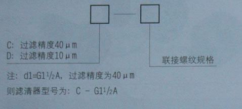

£¨¶þ£©ÐͺÅ˵Ã÷

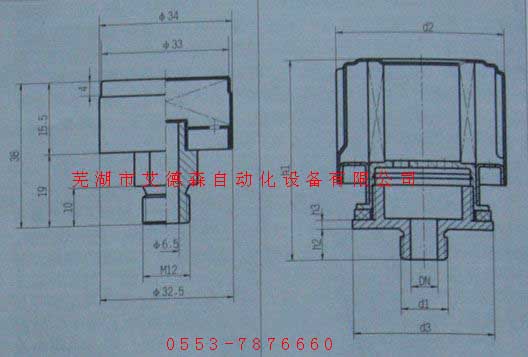

![](/Editor/UploadFiles/products02/200812510217433.jpg)
£¨ËÄ£©¼¼Êõ²ÎÊý¼°ÍâÐͳߴç
¹«³Æͨ¾¶DN |
d1 |
d2 |
d3 |
h1 |
h2 |
h3 |
¿ÕÆøÁ÷Á¿£¨m3/min£© |
ÆÕͨÂÝÎÆ |
¹ÜÂÝÎÆ |
C |
D |
6.5 |
M12 |
25 |
M33¡Á2 |
G 1A |
113 |
96 |
102 |
17 |
6 |
3.0 |
1.0 |
32 |
M42¡Á2 |
G 1 1/4A |
19 |
40 |
M48¡Á2 |
G 1 1/2A |
150 |
115 |
140 |
19 |
7 |
4.0 |
50 |
M60¡Á2 |
G 2A |
22 |
65 |
M76¡Á2 |
G 2 1/2A |
24 |
9 |
80 |
M90¡Á2 |
G 3A |
256 |
186 |
147 |
26 |
6.3 |
2.5 |
