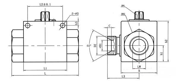

ÍâÐγߴç
![](/Editor/UploadFiles/products02/2008125103456592.jpg)
³ß´ç±í Á¬½Ó¿ÚÂÔͼ:
![](/Editor/UploadFiles/products02/2008125103456141.jpg)
