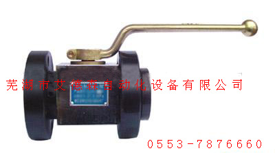

Ïêϸ˵Ã÷£º
![](/Editor/UploadFiles/products02/2008125103730239.jpg)
KHBF(KHMF)ϵÁз¨À¼Ê½Çò·§ |
ͼÐηûºÅ
![](/Editor/UploadFiles/products02/2008125103730272.jpg)
ÐͺÅ˵Ã÷
![](/Editor/UploadFiles/products02/2008125103731148.jpg)
¢Ù ϵÁдúºÅ£ºKHBF£¨KHMF£©ÏµÁз¨À¼Ê½Çò·§
¢Ú ¹«³Æͨ¾¶£º16¡¢20¡¢25¡¢32¡¢40¡¢50mm
¢Û ѹÁ¦·¶Î§£º40¡¢63¡¢100¡¢160¡¢250¡¢315bar
¢Ü ·§Ìå²ÄÁÏ£º1-¸Ö
¢Ý ÇòÌå²ÄÁÏ£º1-¸Ö
¢Þ ¹¤×÷ζȣº1¡¢-25¡«£«100¡æ¡¢2¡¢-30¡«£«170¡æ
¢ß ÆäËûÃܷ⣺2-¶¡ÇçÏð½º
¢à ÊÖ±úÐÎʽ£º02-ÂÁÖÊÖ±±ú06-¸ÖÖÊÇú±ú09-²»´øÊÖ±ú
¢á Éè¼ÆÐòºÅ£ºÓÉÉú²úÉ̶¨

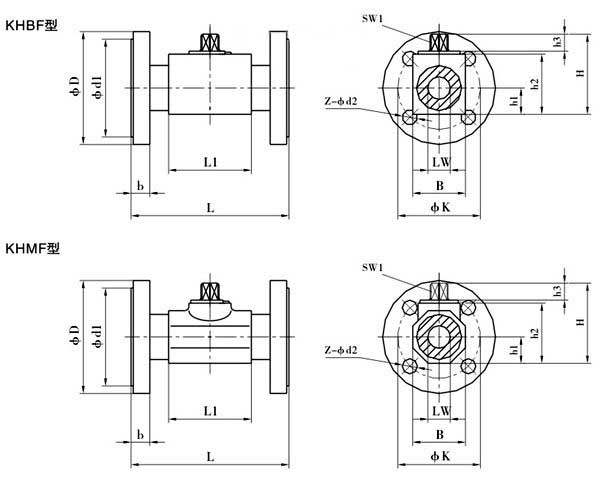

ÍâÐγߴç
![](/Editor/UploadFiles/products02/2008125103731840.jpg)
³ß´ç±í
¼òÂÔÐͺŠ|
ѹÁ¦·¶Î§ |
DN |
LW |
L |
L1 |
D |
d1 |
d2 |
K |
B |
b |
H |
h1 |
h2 |
h3 |
SW1 |
Z |
KHBF-016 |
10-40 |
16 |
15 |
130 |
48 |
95 |
45 |
14 |
65 |
38 |
16 |
62 |
19 |
45 |
11 |
9 |
4 |
KHBF-016 |
63-160 |
105 |
14 |
75 |
20 |
KHBF-016 |
250-315 |
130 |
18 |
90 |
26 |
KHBF-020 |
10-40 |
20 |
20 |
150 |
60 |
105 |
58 |
14 |
75 |
48 |
18 |
75 |
25 |
57 |
11 |
12 |
4 |
KHBF-025 |
10-40 |
25 |
25 |
160 |
65 |
115 |
68 |
14 |
85 |
57 |
18 |
82 |
28.5 |
64 |
11 |
12 |
4 |
KHBF-025 |
63-160 |
140 |
18 |
100 |
24 |
KHBF-025 |
250 |
150 |
22 |
105 |
28 |
KHBF-025 |
315 |
160 |
22 |
115 |
34 |
¼òÂÔÐͺŠ|
ѹÁ¦·¶Î§ |
DN |
LW |
L |
L1 |
D |
d1 |
d2 |
k |
B |
b |
H |
h1 |
h2 |
h3 |
SW1 |
Z |
KHMF-032 |
10-40 |
32 |
30 |
180 |
84 |
140 |
78 |
18 |
100 |
75 |
18 |
103 |
37.5 |
84 |
12 | | | |
