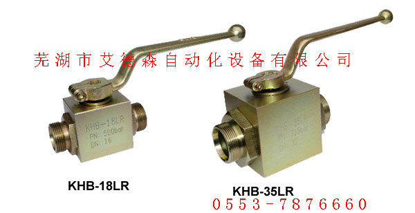

Ïêϸ˵Ã÷£º
![](/Editor/UploadFiles/products02/2008125103914211.jpg)
KHB(BKH)¡¢KHM(MKH)ϵÁиßѹÇò·§ |
ͼÐηûºÅ
![](/Editor/UploadFiles/products02/2008125103914919.jpg)
ÐͺÅ˵Ã÷
![](/Editor/UploadFiles/products02/2008125103914157.jpg) ¢Ù ϵÁдúºÅ£ºKHB£¨BKH£©ÏµÁС¢KHM£¨MKH£©ÏµÁÐ ¢Ú Á¬½Ó´úºÅ£ºM** ¡¢G** ¡¢ **LR ¡¢**SR¡¢PT**¡¢NPT** ¢Û ·§Ìå²ÄÁÏ£º1-¸Ö¡¢2-²»Ðâ¸Ö ¢Ü ÇòÌå²ÄÁÏ£º1-¸Ö¡¢2-»ÆÍ¡¢3-²»Ðâ¸Ö ¢Ý ¹¤×÷ζȣº1¡¢-25¡«£«100¡æ 2¡¢-30¡«£«170¡æ ¢Þ ÆäËûÃܷ⣺2-¶¡ÇçÏ𽺡¢4-·úÏ𽺠¢ß ÊÖ±úÐÎʽ£º01-ÂÁÖÊÖ±±ú02-ÂÁÖÊÇú±ú03-Öýпֱ±ú04-ÖýпÇú±ú05-¸ÖÖÊÖ±±ú06-¸ÖÖÊÇú±ú09-²»´øÊÖ±ú ¢à Éè¼ÆÐòºÅ£ºÓÉÉú²úÉ̶¨ ¢á ±íÃæ´¦Àí£º¿Õ°×-Á×»¯¡¢G-µç¶Æ»Æп

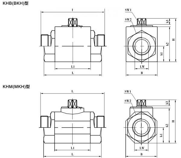

ÍâÐγߴç
![](/Editor/UploadFiles/products02/2008125103915363.jpg)
³ß´ç±í Á¬½Ó¿ÚÂÔͼ:
![](/Editor/UploadFiles/products02/2008125103915303.jpg)
¼òÂÔÐͺŠ|
PN(bar) |
DN |
LW |
RA |
d1 |
i |
L
L1 |
B |
H |
h1 |
h2 |
h3 |
SW1 |
SW2 |
KHB-M16¡Á1.5 |
500 |
06 |
06 |
11 |
M16¡Á1.5 |
11 |
69 |
40 |
26 |
45 |
13.5 |
33 |
8 |
09 |
22 |
KHB-M22¡Á1.5 |
500 |
08 |
08 |
16 |
M22¡Á1.5 |
12 |
76 |
42 |
32 |
49 |
16 |
36 |
10 |
09 |
27 |
KHB-M27¡Á1.5 |
500 |
10 |
10 |
20 |
M27¡Á1.5 |
12 |
76 |
42 |
32 |
49 |
16 |
36 |
10 |
09 |
27 |
KHB-M30¡Á1.5 |
400 |
16 |
15 |
24 |
M30¡Á1.5 |
13 |
84 |
48 |
38 |
61 |
19 |
45 |
11 |
09 |
32 |
KHB-M36¡Á2 |
315 |
20 |
20 |
30 |
M36¡Á2 |
15 |
103 |
60 |
48 |
70 |
25 |
55 |
11 |
12 |
41 |
KHB-M42¡Á2 |
315 |
25 |
23 |
35 |
M42¡Á2 |
18 |
116 |
65 |
57 |
79 |
28.5 |
64 |
11 |
12 |
50 |
KHB-M52¡Á2 |
315 |
32 |
32 |
40 |
M52¡Á2 |
20 |
149 |
84 |
75 |
101 |
37.5 |
84 |
12 |
14 |
60 |
KHB-M60¡Á2 |
315 |
40 |
38 |
45 |
M60¡Á2 |
22 |
174 |
91 |
85 |
112 |
42.5 |
95 |
12 |
14 |
70 | ![](/Editor/UploadFiles/products02/2008125103915648.jpg)
¼òÂÔÐͺŠ|
PN(bar) |
DN |
LW |
RA |
d1 |
i |
L
L1 |
B |
H |
h1 |
h2 |
h3 |
SW1 |
SW2 |
KHB-G1/8 |
500 |
04 |
06 |
G1/8 |
10 |
69 |
40 |
26 |
45 |
13.5 |
33 |
8 |
09 |
22 |
KHB-G1/4 |
500 |
06 |
06 |
G1/4 |
14 |
69 |
40 |
26 |
45 |
13.5 |
33 |
8 |
09 |
22 |
KHB-G3/8 |
500 |
10 |
10 |
G3/8 |
14 |
72 |
42 |
32 |
49 |
16 |
36 |
10 |
09 |
27 |
KHB-G1/2 |
500 |
13 |
12 |
G1/2 |
16 |
83 |
48 |
35 |
49 |
17 |
40 |
10 |
09 |
30 |
KHB-G1/2 |
400 |
16 |
15 |
G1/2 |
16 |
83 |
48 |
38 |
61 |
19 |
45 |
11 |
09 |
32 |
KHB-G3/4 |
315 |
20 |
20 |
G3/4 |
18 |
95 |
60 |
48 |
70 |
25 |
55 |
11 |
12 |
41 |
KHB-G1 |
315 |
25 |
25 |
G1 |
21 |
113 |
65 |
57 |
79 |
28.5 |
64 |
11 |
12 |
50 |
KHB-G 11/4 |
315 |
32 |
32 |
G 11/4 |
22 |
110 |
84 |
75 |
101 |
37.5 |
84 |
12 |
14 |
60 |
KHB-G 11/2 |
315 |
40 |
38 |
G 11/2 |
24 |
130 |
91 |
85 |
112 |
42.5 |
95 |
12 |
14 |
70 |
KHB-G2 |
315 |
50 |
48 |
G2 |
26 |
140 |
100 |
105 |
131 |
52.5 |
112 |
12 |
14 |
80 |
¼òÂÔÐͺŠ|
PN(bar) |
DN |
LW |
RA |
d1 |
i |
L
L1 |
B |
H |
h1 |
h2 |
h3 |
SW1 |
SW2 |
KHB-NPT1/8 |
500 |
04 |
06 |
NPT1/8 |
10 |
69 |
40 |
26 |
45 |
13.5 |
33 |
8 |
09 |
22 |
KHB-NPT1/4 |
500 |
06 |
06 |
NPT1/4 |
14 |
69 |
40 |
26 |
45 |
13.5 |
33 |
8 |
09 |
22 |
KHB-NPT3/8 |
500 |
10 |
10 |
NPT3/8 |
14 |
72 |
42 |
32 |
49 |
16 |
36 |
10 |
09 |
27 |
KHB-NPT1/2 |
500 |
13 |
12 |
NPT1/2 |
16 |
83 |
48 |
35 |
49 |
17 |
40 |
10 |
09 |
30 |
KHB-NPT1/2 |
400 |
16 |
15 |
NPT1/2 |
16 |
83 |
48 |
38 |
61 |
19 |
45 |
11 |
09 |
32 |
KHB-NPT3/4 |
315 |
20 |
20 |
NPT3/4 |
18 |
95 |
60 |
48 |
70 |
25 |
55 |
11 |
12 |
41 |
KHB-NPT1 |
315 |
25 |
25 |
NPT1 |
21 |
113 |
65 |
57 |
79 |
28.5 |
64 |
11 |
12 |
50 |
KHB-NPT 11/4 |
315 |
32 |
32 |
NPT 11/4 |
22 |
110 |
84 |
75 |
101 |
37.5 |
84 |
12 |
14 |
60 |
KHB-NPT 11/2 |
315 |
40 |
38 |
NPT 11/2 |
24 |
130 |
91 |
85 |
112 |
42.5 |
95 |
12 |
14 |
70 |
KHB-NPT2 |
315 |
50 |
48 |
NPT2 |
26 |
140 |
100 |
105 |
131 |
52.5 |
112 |
12 |
14 |
80 |
¼òÂÔÐͺŠ|
PN(bar) |
DN |
LW |
RA |
d1 |
i |
L
L1 |
B |
H |
h1 |
h2 |
h3 |
SW1 |
SW2 |
KHB-06LR |
500 |
04 |
04 |
06 |
M12¡Á1.5 |
10 |
67 |
40 |
26 |
45 |
13.5 |
33 |
8 |
09 |
22 |
KHB-08LR |
500 |
06 |
06 |
08 |
M14¡Á1.5 |
10 |
67 |
40 |
26 |
45 |
13.5 |
33 |
8 |
09 |
22 |
KHB-10LR |
500 |
08 |
08 |
10 |
M16¡Á1.5 |
11 |
74 |
42 |
32 |
49 |
16 |
36 |
10 |
09 |
27 |
KHB-12LR |
500 |
10 |
10 |
12 |
M18¡Á1.5 |
11 |
74 |
42 |
32 |
49 |
16 |
36 |
10 |
09 |
27 |
KHB-15LR |
500 |
13 |
12 |
15 |
M22¡Á1.5 |
12 |
82 |
48 |
35 |
53 |
17 |
40 |
10 |
09 |
30 |
KHB-15LR |
500 |
12 |
12 |
15 |
M22¡Á1.5 |
12 |
82 |
48 |
38 |
61 |
19 |
45 |
11 |
09 |
32 |
KHB-18LR |
500 |
13 |
12 |
18 |
M26¡Á1.5 |
12 |
82 |
48 |
35 |
53 |
17 |
40 |
10 |
09 |
30 |
KHB-18LR |
400 |
16 |
15 |
18 |
M26¡Á1.5 |
12 |
82 |
48 |
38 |
61 |
19 |
45 |
11 |
09 |
32 |
KHB-22LR |
315 |
20 |
19 |
22 |
M30¡Á2 |
14 |
101 |
60 |
48 |
70 |
25 |
55 |
11 |
12 |
41 |
KHB-28LR |
315 |
25 |
24 |
28 |
M36¡Á2 |
14 |
108 |
65 |
57 |
79 |
28.5 |
64 |
11 |
12 |
50 |
KHB-35LR |
315 |
32 |
30 |
35 |
M45¡Á2 |
16 |
141 |
84 |
75 |
101 |
37.5 |
84 |
12 |
14 |
60 |
KHB-42LR |
315 |
40 |
36 |
42 |
M52¡Á2 |
16 |
162 |
91 |
85 |
112 |
42.5 |
95 |
12 |
14 |
70 |
¼òÂÔÐͺŠ|
PN(bar) |
DN |
LW |
RA |
d1 |
i |
L
L1 |
B |
H |
h1 |
h2 |
h3 |
SW1 |
SW2 |
KHB-08SR |
500 |
04 |
05 |
08 |
M16¡Á1.5 |
12 |
73 |
40 |
26 |
45 |
13.5 |
33 |
8 |
09 |
22 |
KHB-10SR |
500 |
06 |
06 |
10 |
M18¡Á1.5 |
12 |
73 |
40 |
26 |
45 |
13.5 |
33 |
8 |
09 |
22 |
KHB-12SR |
500 |
08 |
08 |
12 |
M20¡Á1.5 |
12 |
76 |
42 |
32 |
49 |
16 |
36 |
10 |
09 |
27 |
KHB-14SR |
500 |
10 |
10 |
14 |
M22¡Á1.5 |
14 |
80 |
42 |
32 |
49 |
16 |
36 |
10 |
09 |
27 |
KHB-16SR |
500 |
13 |
12 |
16 |
M24¡Á1.5 |
14 |
86 |
48 |
35 |
53 |
17 |
40 |
10 |
09 |
30 |
KHB-16SR |
500 |
12 |
12 |
16 |
M24¡Á1.5 |
14 |
86 |
48 |
38 |
61 |
19 |
45 |
11 |
09 |
32 |
KHB-20SR |
500 |
13 |
12 |
20 |
M30¡Á2 |
16 |
90 |
48 |
35 |
53 |
17 |
40 |
10 |
09 |
30 |
<, TR bgColor=#ffffff>
KHB-20SR |
400 |
16 |
15 |
20 |
M30¡Á2 |
16 |
90 |
48 |
38 |
61 |
19 |
45 |
11 |
09 |
32 |
KHB-25SR |
315 |
20 |
20 |
25 |
M36¡Á2 |
18 |
109 |
60 |
48 |
70 |
25 |
55 |
11 |
12 |
41 |
KHB-30SR |
315 |
25 |
25 |
30 |
M42¡Á2 |
20 |
120 |
65 |
57 |
79 |
28.5 |
64 |
11 |
12 |
50 |
KHB-38SR |
315 |
32 |
30 |
38 |
M52¡Á2 |
22 |
153 |
84 |
75 |
101 |
37.5 |
84 |
12 |
14 |
