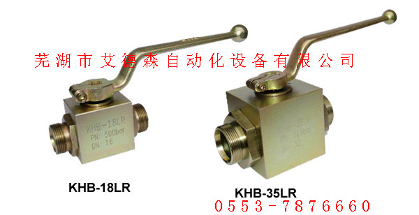

KHB-LRÐÍ
![](/Editor/UploadFiles/products02/200812510404524.jpg)
KHB(BKH)¡¢KHM(MKH)ϵÁиßѹÇò·§ |

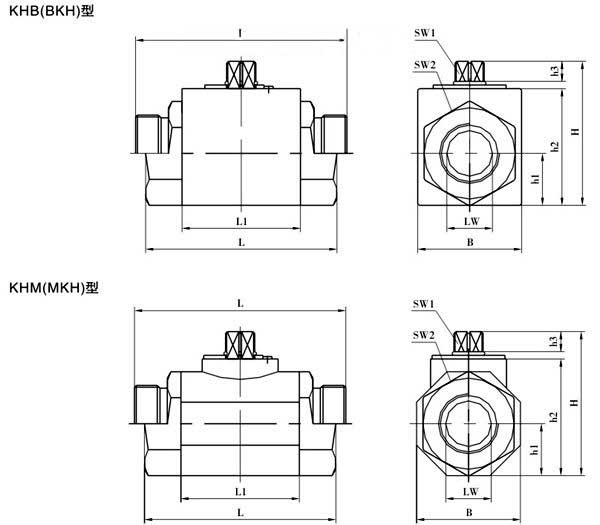

ÍâÐγߴç
![](/Editor/UploadFiles/products02/200812510405617.jpg)
³ß´ç±í Á¬½Ó¿ÚÂÔͼ:
![](/Editor/UploadFiles/products02/200812510406856.jpg)
