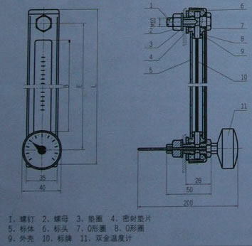

£¨Ò»£©¼ò½é
CYW£76¡«500ϵÁд«¸ÐʽҺλҺμÆÊÇÎÒ³§ÔÚÅúÁ¿Éú²úCYW£76¡«500ϵÁеĻù´¡É¾£¬²Î¿¼¹úÍâÏȽø¼¼Êõ×ÊÁÏ¿ª·¢µÄÒ»ÖÖвúÆ·¡£
ËüÊÇÀûÓÃË«½ðÊôƬÈÈÕÍÀäËõÁéÃô¶ÈÏ൱¸ßµÄÌصãÀ´²âÁ¿ÓÍÒºµÄζȡ£ÕâÑùÒDZí¾ßÓÐ׼ȷ¶È¸ß£¬¶ÁÊýÈÝÒ×£¬¼á¹ÌÄÍÕðµÈÌص㣬¿É¹ã·ºÓ¦ÓÃÓÚ¸÷ÖÖÓÍÏä¡¢Èó»¬×°Öá¢ÀäÈ´ºÍ³ÝÂÖ´«¶¯ÏäÖеÄҺλҺβâÁ¿¡£

(¶þ)Ö÷Òª¼¼Êõ²ÎÊý£º
1¡¢²âÁ¿Î¶ȷ¶Î§£º0¡æ¡«£«100¡æ 2¡¢²âÁ¿Î¶ȷֶÈÖµ£º1¡æ/¸ñ 3¡¢²âÁ¿¾«¶È£º2.5¼¶ 4¡¢³ÐÊÜѹÁ¦£º0.15MPa 5¡¢´«¸Ð¹Ü²åÈë½éÖʳ¤¶È£º>90mm |

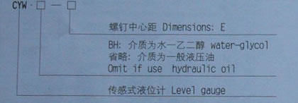

(Èý)ÐͺÅ˵Ã÷

(ËÄ)ÍâÐμ°°²×°³ß´ç£º
![](/Editor/UploadFiles/products02/200812511278438.jpg)
ÐͺŠ|
³ß´ç(mm) |
L |
E |
B |
CYW-76 |
106 |
76 |
37 |
CYW-80 |
110 |
80 |
42 |
CYW-100 |
130 |
100 |
62 |
CYW-125 |
155 |
125 |
87 |
CYW-127 |
157 |
127 |
89 |
CYW-150 |
180 |
150 |
112 |
CYW-160 |
190 |
160 |
122 |
CYW-200 |
230 |
200 |
162 |
CYW-250 |
280 |
250 |
212 |
CYW-254 |
284 |
254 |
216 |
CYW-300 |
330 |
300 |
262 |
CYW-350 |
380 |
350 |
312 |
CYW-400 |
430 |
400 |
362 |
CYW-450 |
380 |
450 |
412 |
CYW-500 |
530 |
500 |
462 | |
