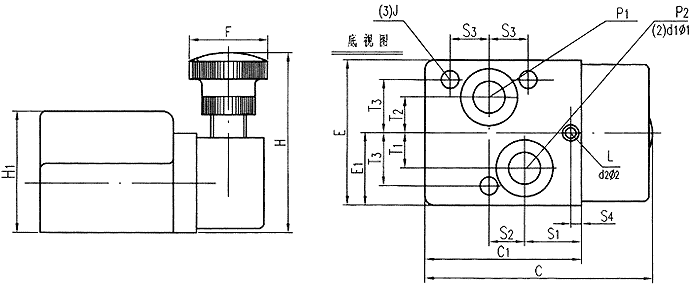

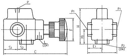

µ¥Ïò˳Ðò·§
Ò»¡¢ÓÃ;
µ¥Ïò˳Ðò·§Óɵ¥Ïò·§ºÍ˳Ðò·§²¢Áª×é³É£¬Æä×÷ÓÃÓë˳Ðò·§Ïàͬ¡£µ±ÓÍÒºÕýÏòͨ¹ýʱ£¬µ¥Ïò·§¹Ø±Õ£¬Ë³Ðò·§¹¤×÷¡£µ±ÒºÁ÷·´Ïòͨ¹ýʱ£¬ÓÍÒº¾µ¥Ïò·§×ÔÓÉͨ¹ý£¬Ë³Ðò·§²»¹¤×÷¡£µ¥Ïò˳Ðò·§XI-25,µ¥Ïò˳Ðò·§XI-63
P1 ½øÓÍ¿Ú£¬P2Ϊ³öÓÍ¿Ú£¬LΪйÓÍ¿Ú(LÓ¦µ¥¶À½Ó»ØÓÍÏä)

Èý¡¢ÍâÐγߴç
¹Üʽ
ÐͺÅ
³ß´ç ºÁÃ×
C×î´ó
C×îС
E
H
S
1
S
2
E
1
H
1
K
1
K
2
F
XI-25
144.5
140
60
76
29
18
30
30
Z
1/8
Z
3/8
¦µ42
XI-63
155.5
151
74
95
34
22
37
37
Z
3/4
°åʽ
ÐͺÅ
³ß´ç ºÁÃ×
C
E
H×î´ó
H×îС
C
1
E
1
H
1
S
1
S
2
S
3
S
4
T
1
T
2
T
3
d
1
¦µ
1
d
2
¦µ
2
J
F
XI-25B
117
66
103.5
99
75
33
75
28
18
19
7
13
13
23
¦µ12
¦µ22
¦µ4
¦µ8
M8X50
¦µ42
XI-63B
128
82
106.5
102
86
41
87
30
22
22
7
19
19
29
¦µ18
¦µ30
¦µ4
¦µ8
M8X60
