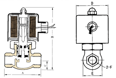

¡ö ÍâÐγߴç
¹æ¸ñ |
A |
B |
C |
D |
E |
F |
US-10 |
83 |
146 |
21 |
¦Õ70 |
42 |
ZG3/8 |
US-15 |
83 |
146 |
21 |
¦Õ70 |
42 |
ZG1/2 |
US-20 |
83 |
146 |
21 |
¦Õ70 |
42 |
ZG3/4 |
US-25 |
90 |
162 |
26 |
¦Õ70 |
52 |
ZG1 |
US-35 |
110 |
183 |
36 |
¦Õ70 |
74 |
ZG11/4 |
US-40 |
110 |
183 |
36 |
¦Õ70 |
74 |
ZG11/2 |
US-50 |
163 |
223 |
47 |
¦Õ70 |
95 |
ZG2 | | |
