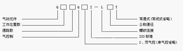

Q23QI|Q23Q2I|Q25QI|Q33QI|Q35QIϵÁÐÆø¿Ø»»Ïò·§
Q23QI-L8T Q23QI-L20T Q23Q2I-L15 Q25QI-L20 Q25Q2I-L25 Q23QI-L8 Q23QI-L20 Q23Q2I-L20 Q25QI-L25 Q35Q2I-L20 Q23QI-L10T Q23QI-L25T Q23Q2I-L25 Q25Q2I-L8 Q35Q2I-L25 Q23QI-L10 Q23QI-L25 Q25QI-L8 Q25Q2I-L10 Q23QI-L15T Q23Q2I-L8 Q25QI-L10 Q25Q2I-L15 Q23QI-L15 Q23Q2I-L10 Q25QI-L15 Q25Q2I-L20
Ò»¡¢ÐͺÅ
![](/Editor/UploadFiles/products02/200812684929616.jpg)
¶þ¡¢Ìصã 1¡¢ÊÇQDIϵÁеÄÅÉÉú²úÆ·£¬ÓÃÆøѶºÅ¿ØÖÆ£¬ÊÊÓÃÓÚ²»ÔÊÐíµçÔ´´æÔڵij¡ºÏ¡£ 2¡¢·ûºÏISO£¨¹ú¼Ê±ê×¼£©£¬»¥»»ÐÔÇ¿¡£

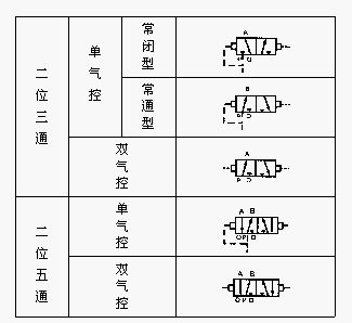

ËÄ¡¢°²×°³ß´ç¼°Í¼ÐηûºÅ
![](/Editor/UploadFiles/products02/200812684930344.jpg)
![](/Editor/UploadFiles/products02/200812684930378.jpg)
