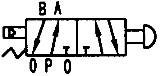

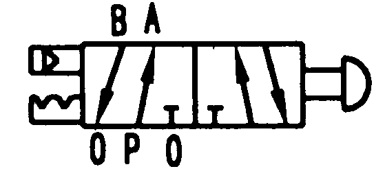

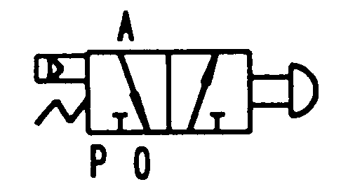

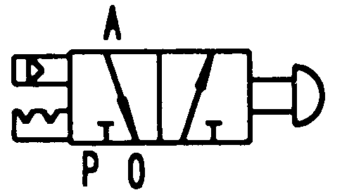

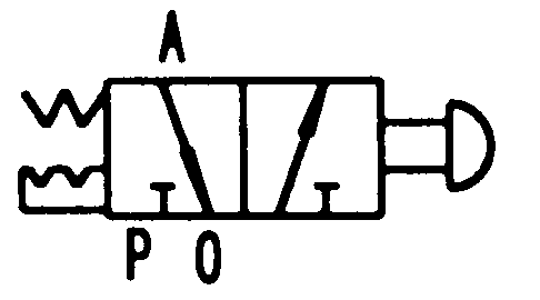

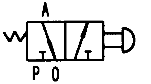

¶þ¡¢Í¼ÐηûºÅ
Àà ±ð |
¶þλÈýͨ£¨³£±Õ£© |
¶þλÈýͨ£¨³£Í¨£© |
¶þλÎåͨ |
Ö±¶¯Ê½(3mm) |
×ÔËø°´Å¥ |
![](/Editor/UploadFiles/products02/200812694918265.gif)
![](/Editor/UploadFiles/products02/200812694918266.gif)
![](/Editor/UploadFiles/products02/200812694918668.gif)
²»×ÔËø°´Å¥ |
![](/Editor/UploadFiles/products02/200812694918120.gif)
![](/Editor/UploadFiles/products02/200812694918860.gif)
![](/Editor/UploadFiles/products02/200812694918674.gif)
Ïȵ¼Ê½(8mm) |
×ÔËø°´Å¥ |
![](/Editor/UploadFiles/products02/200812694918273.gif)
¡¡![](/Editor/UploadFiles/products02/200812694918220.gif) |
![](/Editor/UploadFiles/products02/200812694919565.gif)
²»×ÔËø°´Å¥ |
![](/Editor/UploadFiles/products02/200812694919249.gif)
![](/Editor/UploadFiles/products02/200812694919128.gif)
![](/Editor/UploadFiles/products02/200812694919906.gif)

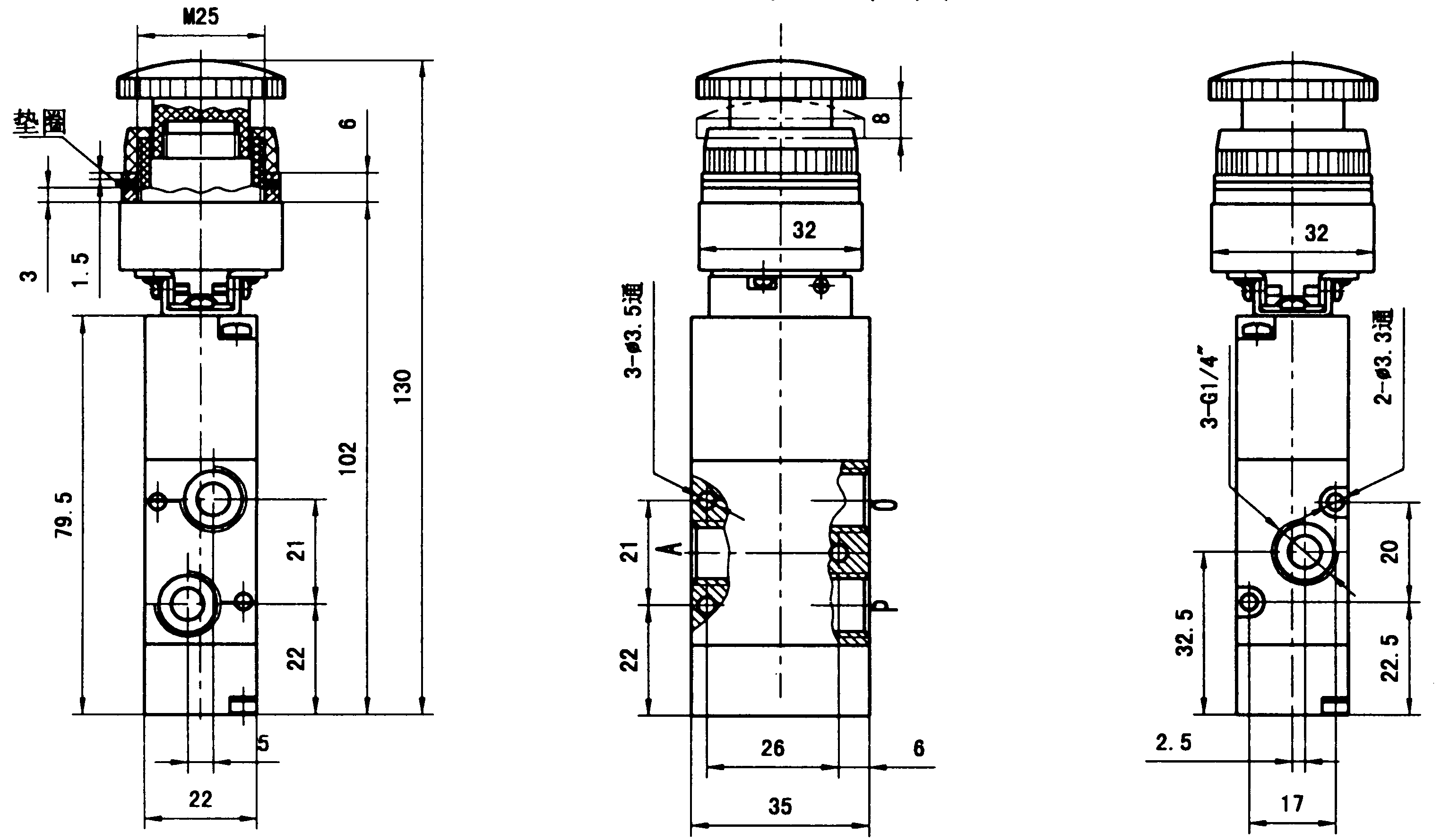

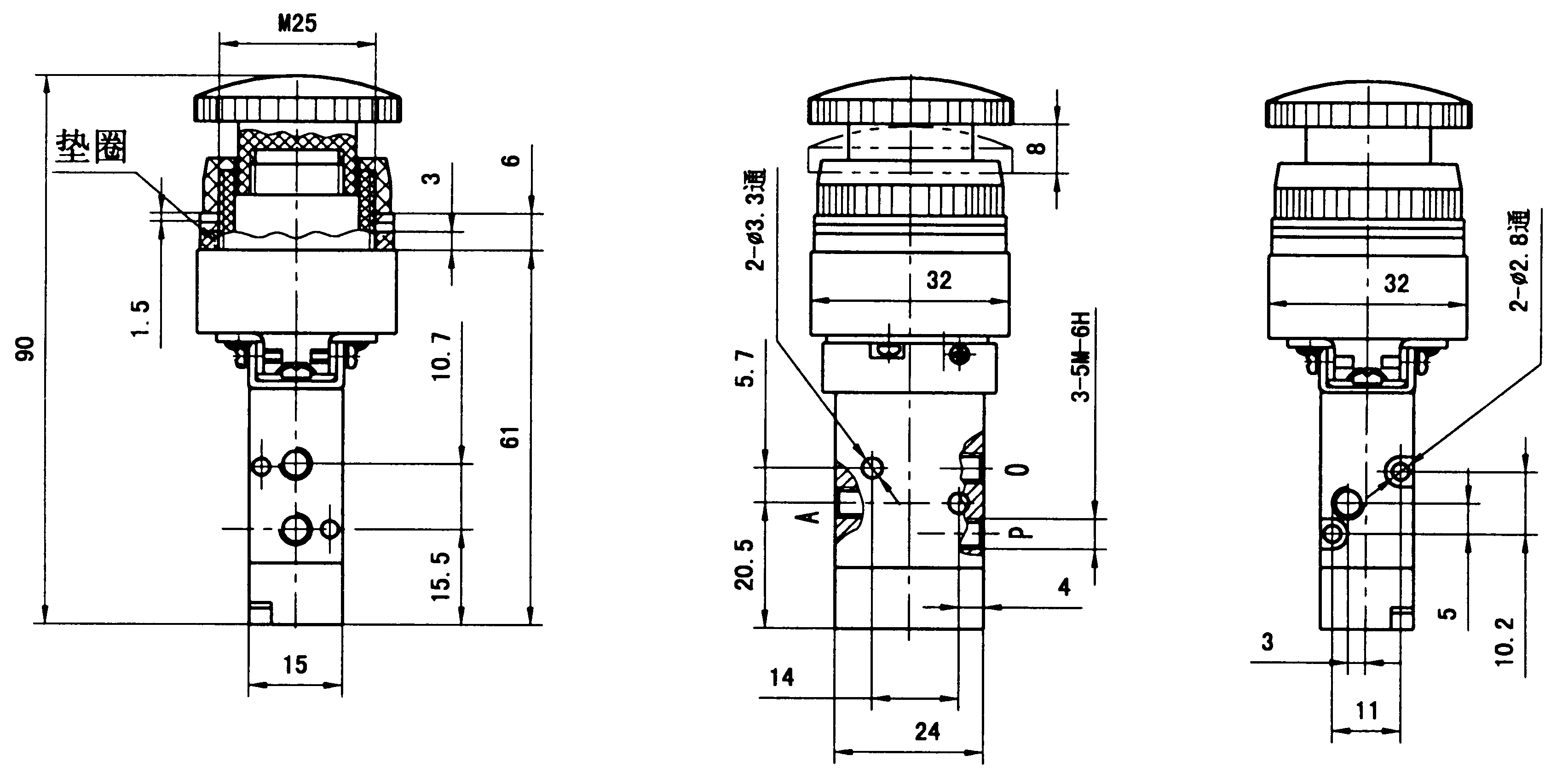

ËÄ¡¢ÍâÐμ°°²×°³ß´ç
3mm¶þλÈýͨ°´Å¥·§ Q23R1C-L3 £¨Q23R1C-L3T£© |
![](/Editor/UploadFiles/products02/200812694919366.gif)
3mm¶þλÈýͨ×ÔËø°´Å¥·§ Q23R1£¨S£©C-L3 [Q23R1£¨S£©C-L3T] |
![](/Editor/UploadFiles/products02/200812694919550.gif)
3mm¶þλÎåͨ°´Å¥·§ Q25R1C-L3 |
![](/Editor/UploadFiles/products02/200812694919681.gif)
3mm¶þλÎåͨ×ÔËø°´Å¥·§ Q25R1£¨S£©C-L3 |
![](/Editor/UploadFiles/products02/200812694919942.gif)
8mm¶þλÈýͨÏȵ¼Ê½°´Å¥·§ Q23XR1C-L8 £¨Q23XR1C-L8T£© |
![](/Editor/UploadFiles/products02/200812694920245.gif)
8mm¶þλÈýͨ Ïȵ¼Ê½×ÔËø°´Å¥·§ Q23XR1£¨S£©C-L8 [Q23XR1£¨S£©C-L8T] |
![](/Editor/UploadFiles/products02/200812694920298.gif)
8mm¶þλÎåͨ Ïȵ¼Ê½°´Å¥·§ Q25XR1C-L8 |
![](/Editor/UploadFiles/products02/200812694920822.gif)
