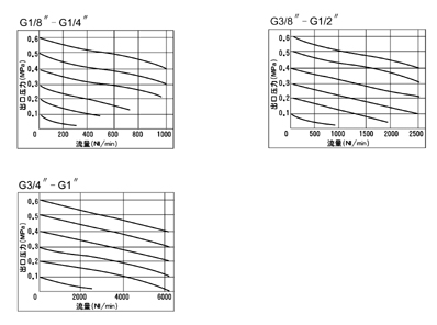

Á÷Á¿ÌØÐÔÇúÏß¡¡¡¡(½ø¿ÚѹÁ¦£Ð£±£½£±£®£°£Í£Ð£á)

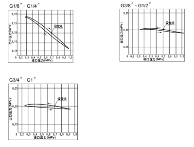

ѹÁ¦ÌØÐÔÇúÏß

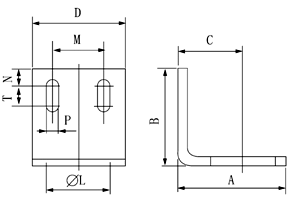

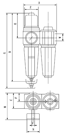

Îå¡¢ÍâÐμ°°²×°³ß´ç:
![](/Editor/UploadFiles/products02/2008126105734270.gif)
ÐͺŠ|
W |
A |
B |
C |
E |
F |
Z |
G |
V |
N |
M |
ÖØÁ¿kg |
399£6 |
G1/8" |
80 |
177 |
40 |
62 |
20 |
M30¡Á1.5 |
202 |
M10¡Á1 |
40 |
70 |
0.810 |
399£8 |
G1/4" |

![](/Editor/UploadFiles/products02/2008126105734342.gif)
¹æ¸ñ.´úºÅ |
A |
B |
C |
D |
L |
M |
N |
P |
T |
G1/8".G1/4" |
48 |
45 |
26 |
45 |
31 |
26 |
15 |
8 |
13 |
G3/8".G1/2" |
80 |
70 |
45 |
70 |
50 |
19 |
15 |
10 |
15 |
G3/4".G1" |
90 |
90 |
50 |
90 |
67 |
50 |
20 |
10.5 |
20 |
