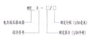

¶þ¡¢Ðͺż°º¬Òå
![](/Editor/UploadFiles/products02/2008126142747401.jpg)

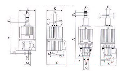

Èý¡¢²úÆ·³ß´ç¼°¸½Í¼
![](/Editor/UploadFiles/products02/2008126142747537.jpg)
