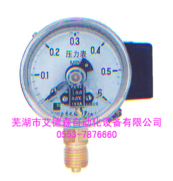

![](/Editor/UploadFiles/products02/2008126155028466.jpg)
YX£¨C£©µç½ÓµãѹÁ¦±í
